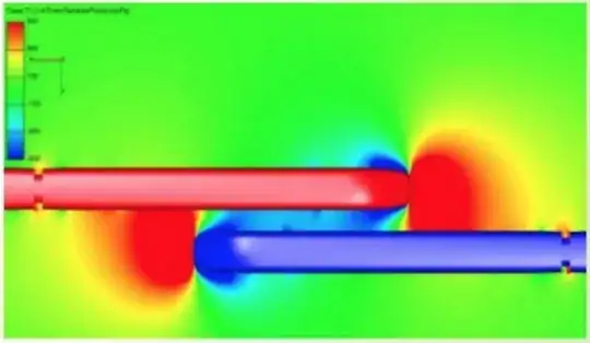

Below is an image depicting the solutions to the pressure equations. It is simple to see how the high pressure in front of the red train would push on the windows and body of the blue train. As the front of the res train passes, the quick transition from medium to high to low pressure would likely snap the windows and outer body of the blue train enough to produce the aforementioned "slapping" sound on the inside of the car. This sound is accentuated by the spaces between cars, and especially the front of the train.
pressure system of two passing trains
To be clear, this paper is probably the best explanation you're going to get on this topic. I've done my best to understand where this described "slapping sound" would come from based on that. The only way I can think of getting more information is to do a more complex simulation or a slow motion video of the outside of the train as the other passes by. It would be cool to see the ripple across the body of the train as the other train passes.
EDIT: To clarify, there are two sources of sound here: 1 - The fronts of the trains hitting each other. And 2 - The pressure difference creating a ripple on the outside of the body of the trains.
