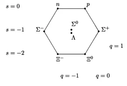

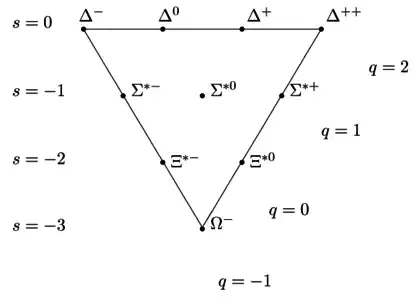

All of the baryons in the spin-1/2 octet except the $\Lambda$ isospin singlet have spin-3/2 excited states in the baryon decuplet. What is it that prevents the existence of a $\Lambda^{*}$ baryon with $I=0$, $s=-1$, and $S=3/2$?

The quark content $uds$ has two baryons in the octuplet, namely $\Sigma^0$ and $\Lambda$. It is no coincidence that there are two of them. It's simply because in the diagram, the 8 components are written according to their weights i.e. eigenvalues of the $U(1)^2$ maximum commuting subgroup of $SU(3)$. And because there are unavoidably 6 components along the hexagon, the remaining 2 must be at the center. Because the 8-dimensional representation is the adjoint, those correspond to nothing else than the two generators of the $U(1)^2$ "Cartan torus" in the Lie algebra.
On the other hand, the decuplet doesn't have any degeneracies of this sort. The 10 components are organized into rows $1+2+3+4$ and there is no doubling anywhere. The component with the $uds$ quark content is just called $\Sigma^{*0}$. It could perhaps be called $\Lambda^*$ as well – because it's really neither. But it's mathematically guaranteed that there is only one component of the decuplet with the $uds$ quark content. It's guaranteed by group theory, by the decomposition of representation of $SU(3)$ under the $U(1)^2$ subgroup (the weights of the representations).

On the other hand, the decuplet is a symmetric tensor $T_{acd}$. You can see that the symmetric tensor admits all combinations of $u,d,s$, and when you specify how many $u$, how many $d$, how many $s$, the component is determined by the symmetry of the tensor. The three corners $uuu,ddd,sss$ are allowed.

The spin 1/2 combination (SU(3) octet) is of mixed symmetry and so is the flavor symmetry of the baryon octet you start with, so it can accommodate both strange isospin singlets (flavor antisymmetric, Λ ) and triplets (symmetric, Σ).
By contrast, the spin 3/2 combination (SU(3) decuplet) is spin symmetric, so it must be flavor symmetric: now it has room for the isotriplet, but none for the strange isosinglet, the Λ . It is all manifest when you look at the explicit SU(6) wavefunctions, 56, in your text.
