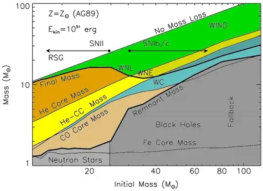

For high-mass stars ($>10 M_\odot$) I offer this plot from a talk by Marco Limongi. The He-core mass tells you roughly the mass co-ordinate of the region that burned hydrogen into helium. Since the initial composition is uniform, that's roughly the fraction of the hydrogen that is burned. So if the He core mass is $5\,M_\odot$ in a $20\,M_\odot$ star, then roughly 25% of the hydrogen is burned. This statement is actually complicated by the fact that some of the unburnt material in the envelope will be mixed into the burning shell, but its gives a rough idea.
Mass--initial mass relation for high mass stars, from a talk by Marco Limongi. This is not meant to be definitive. It is one of a series of similar plots that were used to show how this behaviour changes according to the model. But its useful for illustrating the mass--H-burnt mass relation.
