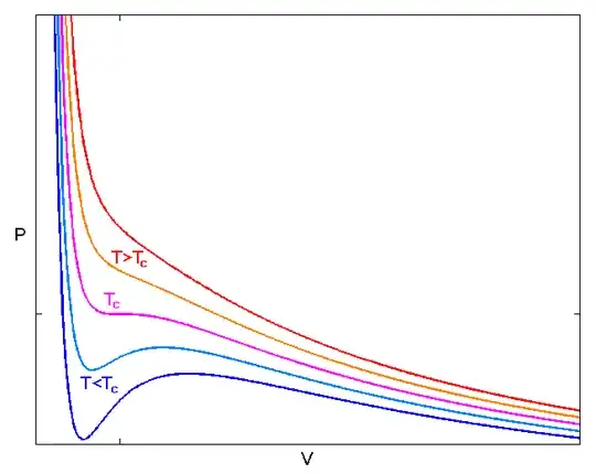

When you plot several Van der Vaals isotherms for a given substance, you observe that some of them show a phase transition from gas to liquid while others do not. The ones which do not show a phase transition are above a so called critical temperature $T_c$. Graph of pressure against volume showing critical temperature Above this temperature you can decrease the volume or increase the pressure of the gas and it will not liquefy.

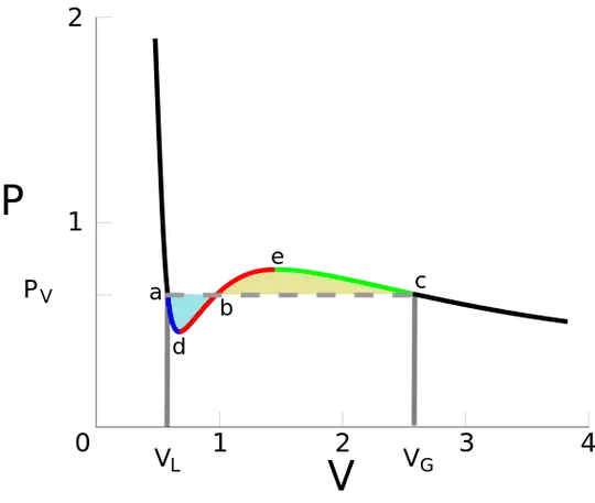

Actually, the isotherms below the critical temperature need a correction given by Maxwell. To avoid instability (lower pressure giving lower volume giving lower pressure...) the actual path in the $PV$ diagram must avoid the "bumps" and follow the dashed line, as in the figure below Graph of P against V with some peaks/troughs bypassed by a dashed line The dashed line is the phase transition region. To see this, notice that if you keep decreasing volume further below $V_L$ you will need a huge amount of pressure. This means we got a liquid. Also notice that if the substance is above the critical temperature there is no need to apply that Maxwell correction. So there is no phase transition. The phase transition prediction by Van der Waals gave him the 1910 Nobel prize in Physics.
