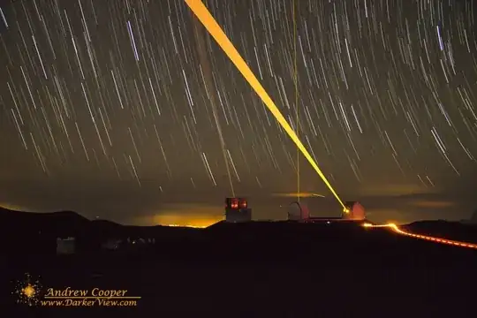

Although the Hubble is a fantastic instrument, it's most certainly not the only source of high-quality deep-sky imagery or data. Every night, there are dozens of active telescopes around the world doing good science and generating beautiful imagery. Adaptive optics has revolutionized terrestrial observing and, as you noted in your question, both aperture and instruments are easier to manage on Earth.
This is a great chance to share this wonderful image by Andrew Cooper showing the artificial guidestars of several observatories a few months ago atop of Mauna Kea: Dualing Lasers atop Mauna Kea Source: http://darkerview.com/darkview/index.php?/archives/2356-Light-Sabers-Atop-Mauna-Kea.html
