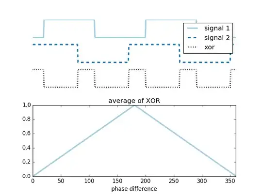

That leads to the second way to get an accurate measurement: by comparing the phase of the emitted and returned signal. If you modulate your laser at a modest 300 MHz, the wave length of one complete "wave" is 1 m; to measure a change in distance of 3 mm (6 mm round trip), it is sufficient to detect a phase shift of $\frac{6}{1000}\times 2\pi$. This is quite trivial with a circuit that squares the transmitted and reflected wave, then takes the XOR of the two signals and averages the result. Such a circuit will give minimum voltage when the two signals are exactly in phase, and maximum voltage when they are exactly out of phase; and the voltage will be very linear with phase shift. You then add a second circuit that detects whether signal 2 is high when signal 1 has a rising edge: that will distinguish whether signal 1 or signal 2 is leading.
Putting the output of the logic gates into a low pass filter (resistor and capacitor) and feeding it into a low speed 12 bit ADC is sufficient to determine the phase with high accuracy. There are ready made circuits that can do this for you - for example, the AD8302
