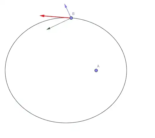

Because the direction of the velocity changes. The velocity will start to point less and less 'towards' point A and when the distance between A and B is the smallest, the velocity will make a right angle with the radius, which means acceleration vector also makes a right angle with the velocity. At this point the radial component of the speed is zero and the total speed is the highest. After this point the acceleration vector will point slightly away from the speed vector and its length will only decrease until it reaches the highest point again.
I have made this image to help you understand with the velocity (red) and radial velocity vector (blue) drawn. Keep in mind that when the radial velocity is decreasing but still pointing towards A, the total velocity is still increasing.
