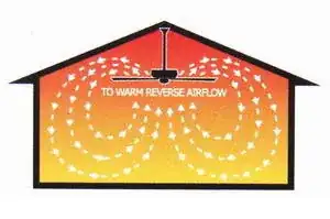

In wintertime, if you have an active heating system at home, it will heat up the air in the room. Hotter air moves up and accumulate near the ceiling, colder air being down. A ceiling fan in reverse direction moves cold air up pushes hot air downwards to people's level. It can do this in forward direction but then you will have the wind chill effect again.

So, in wintertime mode, wind speed above the fan will be higher than that below, there will be a weak stream of air at your level so you will not feel the chill effect.

Either way will warm you in Winter. Either way keeps the air circulating in the room, thereby preventing thermal stratification (i.e., it prevents all the heat from collecting up near your stately cathedral ceiling where it does you no good.)
