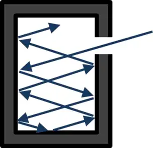

Here are some images from Wikipedia to help frame the question. The first from Blackbody illustrates the familiar cavity in radiative equilibrium with a small hole to sample that radiation.

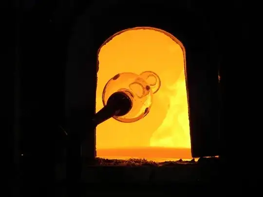

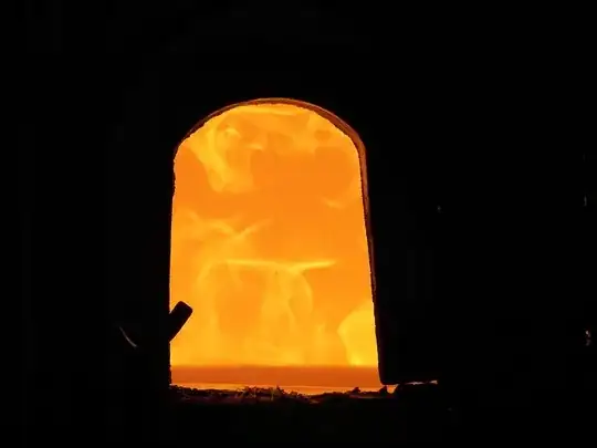

If you visit a Glassblowing factory, studio, or demonstration, you are likely to see something like this, which is roughly similar (except for the flames).
The glass is introduce through the opening to be heated in the furnace, via some combination of absorption of the infrared light and contact with the hot gasses.

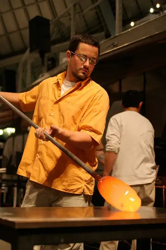

When it is pulled back out, the glass is usually glowing red, orange, or even yellow, depending on temperature,
...so that it softens and is easier to shape.

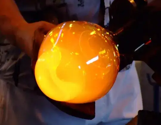

Assume for the purposes of this question that the glass has reached uniform temperature, removed, and the radiation from the glass measured. I believe that most blowing-friendly glasses used in this context are absorbing for at least a large chunk of the infrared.
When I watch the real thing, the glass visually appears to me to be transparent even when it is hot (it's really a beautiful effect!)
Question: Will the visible part of the radiation still approximate a Blackbody spectrum, even though the visible light does not experience several absorptions and re-emissions?
