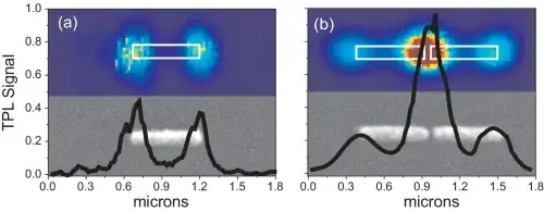

EM Waves are basically spinnings of photons. To create a EM Wave, you basically move some electrons in a directional way(think of an antenna). Electron is a charged particle as well as protons. Charged particles emit photons, and if you emit photons in an ordered way such as this:
Antenna emitting photons
You are seeing a dipol antenna. When you apply negative voltage(intense electron charge referenced to antenna) to antenna input electrons move towards endpoints of the antenna and reflect in opposite if you apply positive voltage electrons will move toward the source so if you apply the voltage(reference electron charge) to antenna in a frequency (and if VSWR of the antenna suits the frequency) you will emit bunch of photons in an order (in a wavelength) in a direction.
And if the photons hit an antenna in the similar order and characteristic like the emitting antenna, photons will absorbed by the antenna and they will push the electrons to higher electron bands and finally electrons will be free due to high energy state and free electrons will create a charge that way. Of course, if you want to carry a meaningful signal(meaningful energy) you have to take care about emitting and receiving antenna characteristics.
EM waves just photon movements in a wave-like order. And photons carry energy. It is simple as that.
