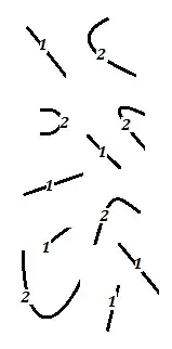

I state this based on a simple duplicatable experiment, understanding thin sheet metal or paper also as a plastic material deformation.
The still remaining ( or remnant) of strained edges or ridges are tell-tale permanent deformations or folds after deformation. Plate & Shell theories in continuum mechanics should perhaps suffice for an explanation.
Going with mechanics of materials understanding... thin paper has some thickness. When unfolded/unravelled after creasing occurs small strain recovery is quite elastic but heavily creased edges must stay put with permanent set pinch marks.
To get a physical feel of this phenomenon take a new A4 paper sheet from printer and crumple it in the hand into as small a ball as possible and then attempt to flatten it out again.. to observe (tiny shallow origamis spread uniformly) the new folds better seen when light is incident laterally.
There are two types of folds discernable, schematically sketched here. Straight Ridge/crease and U-shaped semi arcs/ of local ring. When seen magnified their middle line has still retained the zero Gauss curvature $K$ geometrically.
EDIT1:
By virtue of Gauss Egregium theorem $K$ is conserved at its initial zero value.
Gauss curvature $K= k_1\cdot k_2 = 0$ product of two curvatures.
The first type is visible/recognized as generator lines of cylinders or cones with $ k_1 = 0$
The second type is visible as the crown of a torus demarcating between $ K<0, K>0 $ regions with $k_2 = 0.$
CrumpledPaper
Such folds also appear on Aluminum foil wraps.
Imho we are not into the molecular level here. Please comment.
