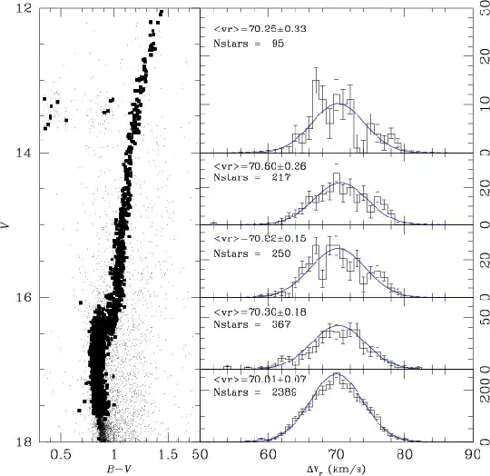

In response to discussion in the comments - globular clusters are very old, usually many times their two-body relaxation timescales. They come into a (virial) equilibrium, where the speed distribution of the stars should be approximately Maxwellian. Yes, the fast moving tail will escape, just like fast moving molecules escape the Earth's atmosphere. But the rate of escape is roughly 1% per relaxation timescale. There is plenty of time for the pseudo-temperature to gradually adjust to such a slow change, meaning that the concept of a temperature can still be used.
Below I show the 1D radial velocity distributions seen in the core of globular cluster M4 (taken from Sommariva et al. 2009). The data are split into bins according to the position in a colour-magnitude diagram (a proxy for stellar mass). The blue lines are Gaussian fits (what you would expect for a Maxwellian velocity distribution) and they are pretty good.The instrumental resolution is of order 0.2 km/s for these observations, so that is a negligible contributor, but there will be some outliers due to binary motion.
Radial velocity dispersions in M4

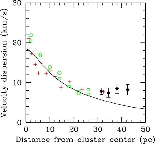

The main effect of stellar escape is that it invalidates the concept of a global temperature (for a similar reason). Clusters cannot be isothermal. The velocity dispersion (and pseudo temperature) must (and is measured to) decrease with radius, otherwise the stars at large radii would escape (see below; the 1D velocity dispersion vs radius for a globular cluster $\omega$ Cen, from Scarpa et al. 2003).
Velocity dispersion vs radius
