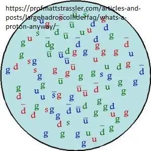

They are composed out of protons and neutrons . Protons and neutrons are composed out of 3 quarks each , between quarks , the strong force described by quantum chromodynamics generates the "bag" where the quarks are tightly bound and exist in a sea of gluons ( the exchange particle of the force) and quark antiquark pairs. Here is a proton:
proton
The image is a good approximation of the large number of gluon exchanges between the valence quarks that hold the nucleus bound in its mass envelope.
