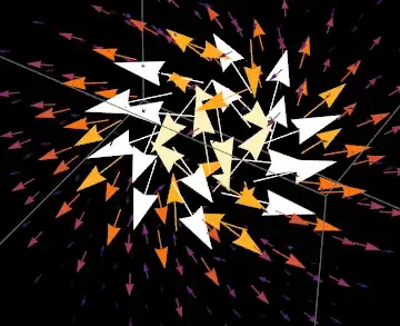

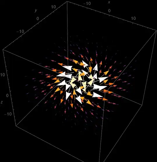

I know that the Poynting flux is the cross product between $\vec E$ fields and $\vec B$ fields, but I'm wondering, are the field lines of the Poynting flux considered as electromagnetic energy? Let's say we have charged particles in this field, would the Poynting flux exert force on them and move them along the field lines?
I have a plot of a Poynting flux that looks like this:
What would happen if there were charged particles in this field?

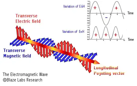

Energy flow associated with wave motion. See this Blaze Labs picture:
The Poynting vector is pointing in the direction the wave is travelling, transporting E=hf energy. Or energy-momentum if you prefer.

I have a plot of a Poynting flux that looks like this: enter image description here
This field looks like it is the field of a charged particle such as a positron. If you placed an electron down near it, linear motion would happen. Counter-rotating vortices attract, co-rotating vortices repel. If you threw the electron past it, rotational motion would also occur.
