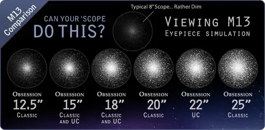

A bigger scope will also give you much brighter and clearer views, here's a comparison from obsession telescopes.
