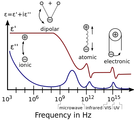

You have to distinguish, which interactions take place, when electromagnetic radiation passes through a solid and interacts with it.
There is a nice plot on Wikipedia, showing the dielectric response of solids for different wavelengths/frequencies.
Dielectric response
Basically, as the frequency gets higher, the wavelength becomes shorter, and the molecules or atoms are no longer able to follow the driving force that is transferred by the electromagnetic wave. Therefore in this picture the real part of the refractive index goes to $ 1 $, while the imaginary part, which leads to optical losses or absorption, goes to $ 0 $.
