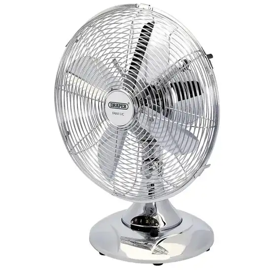

You might be thinking in comparison to a desk or handheld electric fan.
These things start up quickly!

Notice in all of these, the $r$ or $L$ is squared. So since the ceiling fan has longer blades on it than a desk fan does, it'll have a much higher moment, which is responsible for your observation that the $\alpha$ (angular acceleration) is much lower.

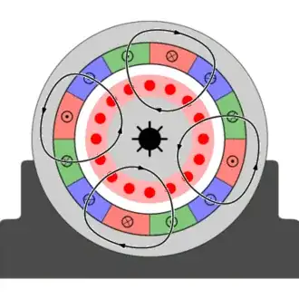

It's a bit complicated (Wikipedia). Induction motors work in sync with the AC frequency but have no torque at 0 RPM so they need some arrangement to get them started. enter image description here
