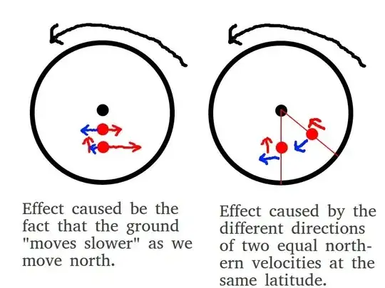

Imagine a train moving directly north at a constant velocity relative to the ground while in the northern hemisphere. As it travels further north, the eastward velocity of the Earth's surface decreases. The ground, therefore, must exert a western force (countering the eastern Coriolis Force) on the train to slow it down to give it a east/west velocity of zero relative to the ground. If we derive the equation for this force, this is exactly 1/2 of the Coriolis effect. We might then, mistakenly reason that all other forces involved are radial (to make it easy, assume the Earth is a perfect sphere). This reasoning is incorrect; consider the picture below.
In this picture, we view the Earth from above the North Pole. Our train (the red dot) is moving northwards. Velocities are in red, and forces are in blue.
Imgur
The left image depicts the effect described above. As the train moves north, the ground goes "slower", so it must exert a westward "force" on the train. This accounts for exactly half of the Coriolis force. (To clarify, the Coriolis Force is directed to the east, and the ground is exerting an opposite westward force on the train).
The right image depicts the other effect in play. Consider two trains moving north at the same speeds and same latitudes, but different longitudes (one is directly east of the other). Clearly, the directions of the train velocities (the two red arrows) are different in 3-D space. The force exerted on the ground by the train cannot be purely radial to transform the velocity of the western train into the velocity of the eastern train (there is clearly a western component of this force). Additionally, the effect is not accounted for in the reasoning above or in the image on the left, since there is no northward displacement (they are both moving north, but are at the same latitude).
In other words, half (it is easy to show mathematically that it is exactly half) of the Coriolis force in this situation is caused by the fact that the ground "moves slower" as we go north, and half is caused by the fact that we must transform our constant northern velocity as the earth rotates and our definition of north changes.
Hopefully this makes it more clear for those who, like me, could follow the math but not the intuition behind the other answers.

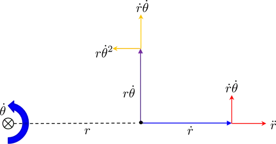

But I find all this confusing. I'd rather look at a picture:
pic
The changes in the velocity vector in radial coordinates (where the center of rotation is in the -x direction. The two $\dot{r} \dot{\theta}$ terms in the coriolis term are from a) turning of $\dot{r}$ and b) extension of $r \dot{\theta}$.
