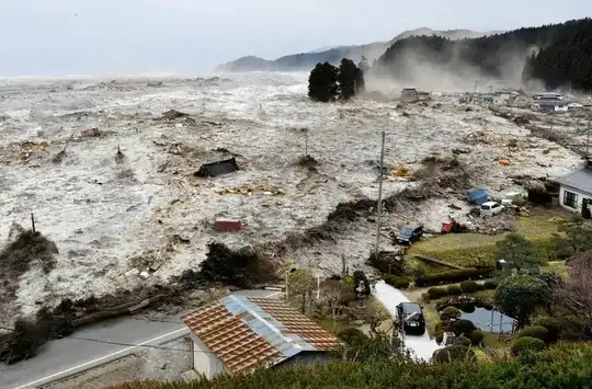

Would it be possible to do this in case of a tsunami? How does the water inside of a tsunami flows?

Due to their sheer broadness, tsunami waves require all the water below then to move at roughly the same speed. For breaking tsunami near the beach, this means around 30kmh
The problem with surviving a tsunami is not the water. It's the stuff in it. Once it has made contact with land, your average tsunami wave will contain cars, tree trunks, shipping containers, houses ground into pieces, rocks, trucks, mud, and all sorts of stuff.
Here's an example video of a small flash flood. If you look at it, that's the kind of "fluid" I'm talking about. It does move like a fluid, but it's basically a grinder. Anyone attempting to swim in there would be bashed by heavy objects, then ground into a pulp, and buried under tons of mud.
