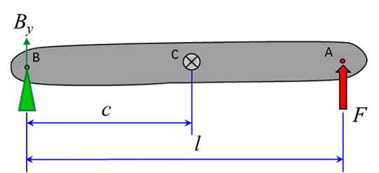

Consider the general case of your problem. A pinned rigid body at B is acted up a short duration force (impact) $F$ at point A. The center of mass is located at C. There is going to be a reaction at the pin $B_y$.
pic
The equations of motion can be expressed at either A, B or C if we take care to account for the proper torques and accelerations.
  • At the center of mass C the term $c \alpha$ is the linear acceleration of the center of mass and $(\ell -c) F$ the torque due to the force $F$. $$ \begin{aligned} F + B_y & = m c \alpha \\ (\ell-c) F - c B_y & = I_C \alpha \end{aligned} $$
  • At the pivot point B the mass moment of inertia $I_C$ is transferred to the pivot using the parallel axis theorem $$ \begin{aligned} F + B_y & = m c \alpha \\ \ell F & = (I_C + m c^2) \alpha \end{aligned} $$
  • At the impact point A there is an inertial load $m \ell \alpha$ and it's torque to account for (see last term of 2nd equation). $$ \begin{aligned} F + B_y & = m c \alpha \\ -l B_y & = (I_C + m d^2) \alpha - m d \ell \alpha \end{aligned} $$ where $d=\ell-c$
For all of the cases above the equations couldn't be solved properly without the equivalent torques on the left hand side and the equivalent accelerations on the right hand size. There are coordinate system locations where linear accelerations are zero (like the pin location), and others where net torque is zero (and therefore not needed). But not at the same time. You either have to account for one or the other or both.
