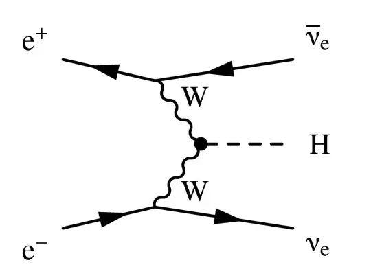

At LEP, the Higgs must have been produced by vector boson fusion, just not enough for us to clearly distinguish it from background:

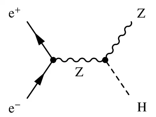

Associated production is also thinkable, but the cross section is very small, since $m_H + m_Z > \sqrt{s}_{LEP}$:

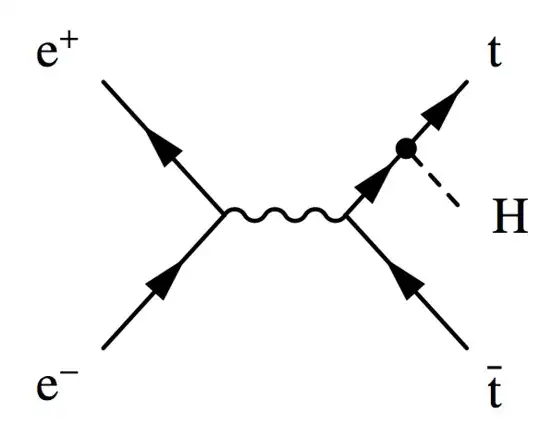

Even smaller would be $ttH$ production:

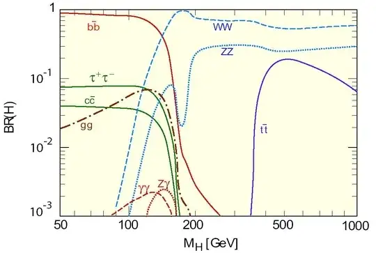

The second reason, and also the general answer to why finding the Higgs was not so easy, lies in the way the Higgs decays:
This image shows the decay channels of the Higgs boson for a given mass. At $125$ GeV, it mostly decays to a $b\bar{b}$ pair. $b$ quarks hadronize and what you see in the detector are two "jets". A two jets event is not a particularly clean signature. In a hadron collider machine, your background is overwhelming. As far as I know, even today, the observation of the $H \to b\bar{b}$ signal has not reached the $3 \sigma$ level in any LHC experiment.
There are two ways around this: Either look for a Higgs produced with another particle or rely on Higgs decaying to other particles. In a Higgs associated production, the $b\bar{b}$ pair is accompanied by a $W/Z$ boson and the sensitivity is much higher, since the background is much smaller. This is what the experiments at the Tevatron observed.
Higgs decaying to $ZZ$ or to $\gamma\gamma$ are particularly clean channels. But the branching fraction $H \to ZZ$ is $2.67$ %, and $H \to \gamma\gamma$ is even only $0.228$ %, so you need a large dataset to see these decays. Such a dataset was not available in time at the Tevatron.
It is interesting to note, that if the Higgs would have been lighter, it would have been produced copiously at LEP, and we would have found it a long time ago. If it would have been heavier, the branching fraction to $b\bar{b}$ would have been considerably smaller, and we would have observed it at the Tevatron. The mass of $125$ GeV simply turned out to be a signal which was hard to distinguish from background, for various, aforementioned reasons. That's why it took so long to find the Higgs.
