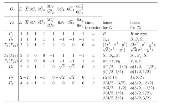

However, character table of double groups does not follow this rule. For example, for two double groups $T_d$ and $O$, the character table is: enter image description here
The character of $\bar{E}$ is positive in most representations. Does this mean that these representations are not physical? If so, it seems crystals with $T_d$ or $O$ symmetry have degeneracies everywhere, which is hardly acceptable to me.
Can anyone help me resolve this issue?
