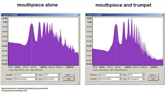

It is not uncommon for some of the higher harmonics to have a larger amplitude. Take a look at the frequency spectrum of a trumpet for example.
Image source: Subtractive Synthesis Concepts by Ed Doering, CC-BY licence.
