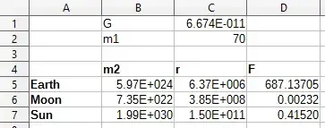

We know the force you feel is
$$ F = G \frac{m_1 m_2}{r^2}$$
Where
  • $G$ is the gravitational constant $6.674×10^{−11} N⋅m^2/kg^2$
  • $m_1$ is your mass, let's say 70 kg.
  • $m_2$ is the mass of the Earth, Moon or Sun.
  • $r$ is the distance between the centre of you and the centre of the Earth, Moon or Sun.
  • $F$ is the resultant force in Newtons.
When I plugged the above into a spreadsheet I got this result
You should note that the value of r for Earth depends on whether you are standing on the equator, at a pole, or somewhere in between, and whether you are at sea level or at the top of a mountain. The variation in force you feel from the Earth when you move a few hundred kilometers horizontally is likely to be greater than the variation caused by the change in direction from you to the Sun or moon.
