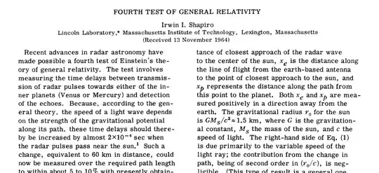

The local speed of light is always measured to be the same because we use the local motion of light to define the second and the metre, and we then use them to measure the local speed of light. It's circular, it's a tautology. Note however that whilst the local speed of light is always measured to be the same, a gravitational field is a place where the speed of light is spatially variable. Einstein said this repeatedly from 1908, but there are some cargo-cult issues in that not many people know about it. This example is from 1920, see the second paragraph:
There's other examples from other years, such as this one from 1915: ""the writer of these lines is of the opinion that the theory of relativity is still in need of generalization, in the sense that the principle of the constancy of the velocity of light is to be abandoned". There's also examples from authors such as Shapiro:
