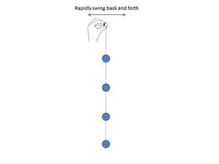

pendulum
Basic "quad" pendulum to demonstrate passive damping through suspension.
LIGO’s passive vibration isolation system absorbs vibrations before they reach the all-important mirrors. One way these vibrations are absorbed is through a pendulum suspension system: LIGO’s main mirrors are suspended at the bottom of 4 pendulums--each node in the pendulum being a hefty mass (LIGO's mirrors alone each weigh 40 kg, or 88 lbs.). Since heavy things don’t like to move (that’s Newton’s Law of Inertia), by their sheer weight, each mass at the top of each step of the 4-step pendulum absorbs vibrations from the mass above it until nothing reaches the lowest, all-important hanging mass: LIGO’s laser-reflecting mirror. To illustrate the effect for yourself, tie four heavy washers or bolts together in a line, each one separated by an equal length of string (see illustration at left). Hold the string at the top and rapidly shake the top back and forth by a small amount (you're simulating vibrations from the environment around LIGO). You'll see that the lowest mass just won’t move much at all compared to how much you're moving the top mass because each mass in the chain absorbs or ‘damps’ the vibration, isolating the last one from a lot of noise above it.
As it suggests, “active” isolation is an active process whereby a set of sensors feels vibrations and sends signals to “force actuators” that generate counter-forces to cancel out vibrations. This is the same basic principle by which noise-cancelling headphones operate. In LIGO's case, the active isolation process actually occurs outside of the suspension system, removing the largest vibrations before they reach the first step in the pendulums described above (as the name implies, LIGO's suspensions are also 'suspended' below the active seismic isolation platforms). The suspensions then remove the smaller vibrations, leaving LIGO’s mirrors perfectly still and primed to detect gravitational waves.
So it is not " ruled out due to the large distance between the two LIGO sites" but because the mirrors are constrained to be at rest, no matter what ground vibrations come up.
