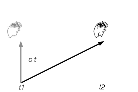

An alien with spectacular vision (that can resolve time differences on the order of 10^-12 seconds) is in a train that is stationary and is looking at a light that is switched on about a meter away from his eye. The light is switched on at time t1 and he perceives it at t2. Now consider the situation when the train starts to move.
The alien sees the same event. There are no windows and there is no way the alien can get information from outside the cabin. According to the fact that the train is not accelerating but moving at a constant velocity, nothing the alien can do should tell him that he is moving. But consider which photons the alien is seeing.
When the light is switched on, the photons go in all directions. In a stationary train, the alien sees the photon going straight up, but in the moving train, the photon that reaches his eye, is the one that takes off from the light at an angle.
Now make a stencil with numbers cut out on it like so:
and put it over the light like so:
When the train is stationary, the alien sees the number '1' but when the train is moving he sees the number '5'. Please forgive the scale. I wanted to make the numbers readable so I made the mask very large. You might be tempted to say that by the time the oblique ray reached the mask, the mask will have moved so the alien will really see a different number (2 maybe?). But make the mask really small so it is really close to the source. And make the stenciling really small so you can resolve small differences.

The answer, of course, is that when the train is moving the person sees the '1' signal in exactly the same way they do when the train is still, because the stencil is moving with the train.
