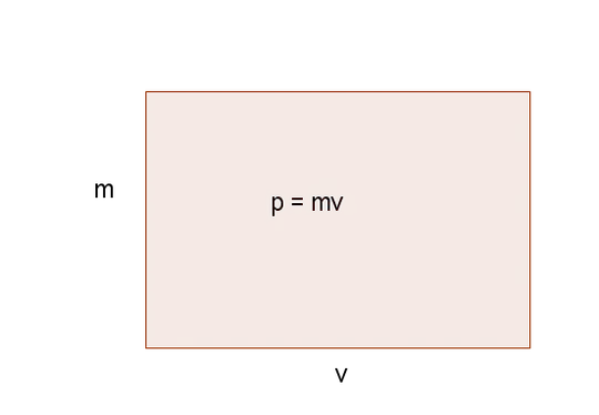

Here is a visualization:
Momentum is mass times velocity, so draw it as the area of a rectangle:

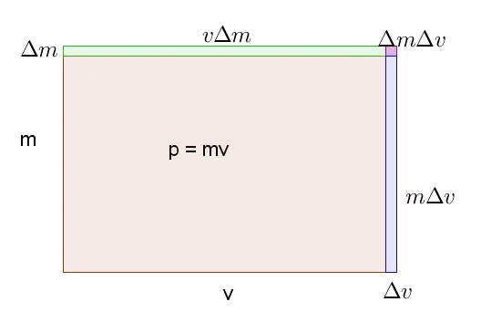

If we change the mass and velocity a little, we change the momentum:
The total change in the momentum is the sum of green, blue, and purple rectangles. Their sizes are just length times width, so overall we have
$\Delta p = m\Delta v + v\Delta m + \Delta v \Delta m$
This looks like the answer you're seeking except for the extra term at the end.
Suppose we cut $\Delta m$ and $\Delta v$ down to one tenth their current size. Then the first two terms become one tenth as large, but $\Delta m \Delta v$ becomes one hundredth as large. The purple box shrinks away much faster than the blue and green ones. Therefore, for very small changes, we can ignore the purple box and write
$\Delta p = \Delta(mv) = m\Delta v + v\Delta m$
we usually indicate this limiting procedure by changing the $\Delta$ to $\mathrm{d}$, so
$\mathrm{d} p = \mathrm{d}(mv) = m\mathrm{d} v + v\mathrm{d} m$
