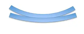

Perhaps this diagram helps:
Notice how the top board is bent through a bigger curvature - that should mean more bending stress, and therefore more tension on the lower surface of the upper board. HOWEVER: if the top board is touching the bottom board (as in this diagram) then NECESSARILY the outer curvature of the top board must equal the inner curvature of the bottom board - and without friction, that means the upper board experiences more stress and should break first. But if there is friction with the surface of the bottom board, that makes the two boards "move as one", with the tension in the top board canceling the compression in the bottom board, and the tensile stress being transferred to the new "outer" surface (that is, the bottom of the lower board).
