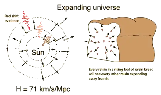

The raisin bread analogy of the expansion of the universe is useful to get an intuition on what is the process.
raisin bread
Why are the raisins not expanding at the rate of expansion of the bread? Because the dough is a soft elastic medium while the raisins are solid.
In exactly the same way, the stability of clusters of galaxies , galaxies and planetary systems is retained because the attractive force of gravity is much stronger than the effective dispersive force exerted by the expansion of the universe . This is more so for systems bound by electromagnetic and strong forces, as your imaginary ruler.
