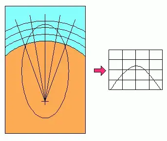

If an object has less than escape velocity (For earth it is 11.2 km/s), its path is an ellipse. If the object has velocity equal to escape velocity, it has a parabolic trajectory. If it is greater than escape velocity, it is hyperbolic.
Normally when we throw an object the actual path of the object is a part of a larger ellipse as the below image shows but since the velocity is not enough the object hits the ground before completing a full elliptical path which seems to be a parabola
The parabolic paths become flatter and flatter as the cannon is fired faster. Newton imagined that the mountain was so high that air resistance could be ignored, and the canon was sufficiently powerful.
PS: Newton's mountain was impossibly high but he realized that the moon's circular path around the earth could be caused by the same gravitational force that pulls cannonball in its orbit, in other words, the same force that causes objects to fall.
The answer to your question is that the path of football is truly "elliptical" since its velocity is way less than escape velocity. But to us, we "approximate its path to a parabola".

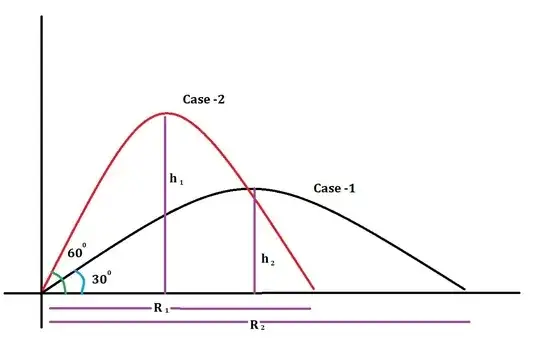

Now from your question we can have to situations:
CASE-1: When the object is thrown inclined at an angle $\theta_1$ with a velocity $u$
Then the maximum height the object will reach is given by:
$\displaystyle h=\frac{u^2\sin^2\theta_1}{2g}$
Now if $\theta_1= 30^\circ$ and initial velocity $u= 100\ \mathrm{m/s}$ (just for consideration)
Then the maximum Height the object will reach is equal to:
$h= 127.55$ meters
Now using the same angle and velocity, if we calculate the maximum distance traveled(called the range of projectile) we have
$\displaystyle R_\text{max}=\frac{u^2\sin2\theta_1}{g}$
Now by plugging in the values, we have $R=883.69$ meters
CASE-2: When the object is thrown at a higher angle than before but with same velocity.
Now say the angle $\theta_2=60^\circ$ (Higher angle than before) and $u=100\ \mathrm{m/s}$
Then by using the same equation used before we have
$h= 382.65$ meters and $R= 441.83$ meters
RESULT:
We can clearly see that the maximum height in case-1 is less than that of case-2 and the maximum range in case-1 is higher than that of case-2
Which means the path in case-1 is less high and more far. But the path in case-2 is higher and less far. See the below image for more clarification.
enter image description here (Sorry for the funky colors :P)
Image source: http://www.faculty.virginia.edu/rwoclass/astr1210/guide08.html; https://www.lhup.edu/~dsimanek/scenario/secrets.htm.
