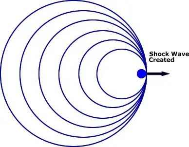

As explained in the answers to this post, photons apparently exert a gravitational pull on other objects. It has also been explained on this site, that gravity propagates at the speed of light.
I'm wondering, though, how do you reconcile these two facts? I'm trying to imagine the gravitational field made by a photon and it seems like there are some paradoxes. For example, how can gravity propagate ahead of the photon at the speed of light, if the photon is also travelling at the speed of light? My guess is the solution is probably found in relativity, but I certainly can't figure it out.
Right now, the best I can do is to think about gravity as sound, and a photon as an object travelling at the speed of sound. Can anyone help me out?

Assuming speed of propagation of gravity same as speed of the photon, the contribution of the photon towards gravity (towards curving the space), can be considered a single shape (a circle, sphere or another appropriately curved shape). The single shape (say, smallest circle in your figure), moves with the photon, and there are no other circles (they just fade away). Now, what is difficult to figure, is given the same speed, the photon may be in the center of the shape, or, it may be towards the front end of the shape. There would not be any shock wave as photon does not have external source of energy to keep creating new waves. It is kind of field that is moving with it.
However, I am not aware of any experiment where speed of propagation of gravity (or of curving of space) has been measured to be equal to c. Gravitational waves have been known to propagate at c, but they are not same as gravity itself. Gravity is always attached to the source while gravitational waves are detached from the source and move on their own once created.
