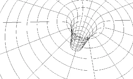

grid
Image: sketch of the supposed space-grid at a given coordinate time as viewed from outside the black hole (note the empty place inside the circle in the center of gravity, which would be a hollow shell in 3D)
So my question is:
Right now, speaking from the perspective of a stationary observer on the outside of the black hole, is there even any space inside a black hole, or is the metric of spacetime warped to form a hollow shell with $\text{r}=\text{r}_s$, if you were to describe it from 1 higher dimension? At least that's what it looks like here, here and here.

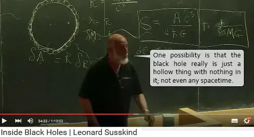

susskind
Image: Susskind saying that even from the perspective of an infalling observer there might not be any spacetime behind the event horizon
For an eternal black hole you could cut out the spacetime beyond the event horizon and do it at the horizon or somewhere inside. Not that the event horizon is as easy to find as that one example of a spherically symmetric static stationary object alone in the universe would have you believe. In fact, being able to cut it off at the event horizon is almost entirely a tautology and completely devoid of content.
You could also use radar distance instead of that higher dimensional embedding and then the event horizon is an infinite radar distance away so it might seem mysterious.
