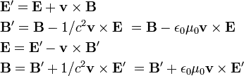

The transformation of the quantities in electrodynamics with respect to boosts are
$$ \begin{alignat}{7} \mathbf{E}'&~=~ \gamma \left(\mathbf{E} + \mathbf{v} \times \mathbf{B}\right) &&+ \left(1 - \gamma\right) \frac{\mathbf{E} \cdot \mathbf{v}}{v^2} \mathbf{v} \\[5px] \mathbf{B}'&~=~\gamma\left(\mathbf{B}-\frac{1}{c^2}\mathbf{v} \times \mathbf{E}\right)&&+\left(1-\gamma\right)\frac{\mathbf{B} \cdot \mathbf{v}}{v^2} \mathbf{v} \\[5px] \mathbf{D}'&~=~ \gamma \left(\mathbf{D}+\frac{1}{c^2} \mathbf{v} \times \mathbf{H} \right) && + \left( 1 - \gamma \right) \frac{\mathbf{D} \cdot \mathbf{v}}{v^2} \\[5px] \mathbf{H}'&~=~ \gamma \left(\mathbf{H} - \mathbf{v} \times \mathbf{D}\right) && +\left(1 - \gamma\right) \frac{\mathbf{H} \cdot \mathbf{v}}{v^2}\mathbf{v} \\[5px] \mathbf{j}' & ~=~ \mathbf{j} - \gamma \rho \mathbf{v} && + \left(\gamma - 1 \right) \frac{\mathbf{j} \cdot \mathbf{v}}{v^2} \mathbf{v} \\[5px] \mathbf{\rho}' & ~=~ \gamma \left(\rho - \frac{1}{c^2} \mathbf{j} \cdot \mathbf{v}\right) \end{alignat} $$where $\gamma \left(v \right)$ and the derivation of the transformation is presented on this Wikipedia page and is most transparent in a space-time geometrical picture, see for example here. Namely, the electromagnetic field strength tensor $F_{\mu\nu}$ incorporates both electric and magnetic field $E,B$ and the transformation is the canonical one of a tensor and therefore not as all over the place as the six lines posted above.
In the non-relativistic limit $v<c$, i.e. when physical boosts are not associated with Lorentz transformations, you have
For the traditional force law, the first formula confirms the prediction that the new $E$ magnitude is $vB$.
Also, beware and always write down the full Lorentz law when doing transformations.
Lastly, I'm not sure if special relativity predicts equivalent electric force will acting upon charge instead is the right formulation you should use, because while the relation is convincingly natural in a special relativistic formulation, the statement itself is more a consistency requirement for the theory of electrodynamics. I'd almost say the argument goes in the other direction: The terrible transformation law of $E$ and $B$ with respect to Galilean transformations was known before 1905 and upgrading the status of the Maxwell equations to be form invariant when translating between inertial frames suggests that the Lorentz transformation (and then special relativity as a whole) is physically sensible.

We can write the Lorentz transform of the fields in a very clean and easy to understand way.
To simplify the expression we use a short hand notation for the various components of the fields parallel and orthogonal to the boost $\vec{\beta}$, further simplified by setting $c$ to $1.$
Lorentz transform of the electromagnetic field
$$ \begin{array}{lclclcl} \mathsf{E}' & = & \mathsf{E}_\| & + & \mathsf{E}_\bot\ \gamma & + & \mathsf{B}_\otimes\ \beta\gamma \\[5px] \mathsf{B}' & = & \mathsf{B}_\| & + & \mathsf{B}_\bot\ \gamma & - & \mathsf{E}_\otimes\ \beta\gamma \end{array} $$
The parallel and orthogonal components are defined, using the unit vector $\hat{\beta}$, as:
$$\begin{array}{lcll} \mathsf{E}_\| &=& \left(~ \hat{\beta}~\cdot~\mathsf{E}~ \right)~\hat{\beta} & \mbox{parallel component with regard to $\vec{\beta}$} \\[5px] \mathsf{E}_\bot &=& \left(~ \hat{\beta}\times \mathsf{E}~ \right)\times\hat{\beta} & \mbox{orthogonal component with regard to $\vec{\beta}$} \\[5px] \mathsf{E}_\otimes &=& \left(~ \hat{\beta}\times \mathsf{E}~~ \right) & \mbox{$90^o$ rotated orthogonal component} \end{array}$$
So in words:
  • The fields parallel to the boost don't change
  • The fields orthogonal to the boost are multiplied with $\gamma$
  • The $E$ and $B$ fields fields orthogonal to the boost are converted into each other.
For more see this chapter from my book (PDF).
