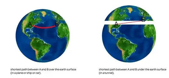

I have this idea and I don't know how to process, explain or question it. I hope you can understand these images and help me formulating a good question.
Shortest path between A and B
This is like a gravitational train but it doesn't goes to the antipodes, just like a tunnel that cuts a slice of earth.

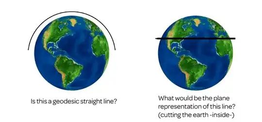

What kind of line are those?
In this image I tried to express a straight path in a round surface. If I walk 1000 meters forward I will go to the shortest way and that way is a straight line. But if instead of walking, I dig a tunnel and, that path or way is still a straight line? Or from my point of view I will see that tunnel curved?
I'm really trying to figure out this. I don't have any scientific education and english is not my first language but I'm very curious and I'm hungry for knowledge :)
The shortest distance between two points in 3D space is a line; if the path is not a line it is called a curve.
If you are confined to a surface, the shortest distance between two points is called a geodesic. For example, the geodesics of a spherical surface are the great circles: circles whose centers pass through the center of the sphere. Lines of longitude on a globe are great circles, as is the equator.
So your proposed tunnels, straight lines, directly connecting two points on the earth's surface, are indeed the shortest possible paths.
