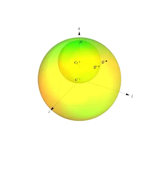

To visualize these maps, one can imagine the Jones vectors as unit quaternions, so that $(z_1,\,z_2) \cong \mathrm{Re}(z_1) + \mathrm{Im}(z_1)\,\mathbf{i} + \mathrm{Re}(z_2)\,\mathbf{j} + \mathrm{Im}(z_2)\,\mathbf{k}$. In this representation, multiplication of both Jones vector elements by a common phase factor corresponds to after-multiplication (recall quaternion multiplication is non-commutative) by the unit quaternion $\exp(\theta\,\mathbf{k}),\,\theta\in\mathbb{R}$. By doing so, any unit quaterion can be translated to the so-called equatorial sphere $\mathbb{E}$ of pure quaternions with no real part. Indeed, there are two phases that will do this; one puts the quaternion on the Northern hemisphere, the other on the antipodean point on the Southern hemisphere. We chose one hemisphere consistently, say the North. Nextly as in the diagram below, we project the Northern hemisphere point $Q$ to the point $Q^\prime$ on the 2-sphere $\left\{q_x\,\mathbf{i}+q_y\,\mathbf{j}+q_z\,\mathbf{k}|\;\left(q_x-\frac{1}{2}\right)^2+q_y^2+q_z^2=\frac{1}{2};\;q_x \geq0\right\}$ of radius $\frac{1}{2}$ centered at $\frac{1}{2}\,\mathbf{i}$ with the center $C$ of $\mathbb{E}$ as the projection point. It is easy to show that $\angle Q\,C\,N$ is half of $\angle Q^\prime\,C_2\,N$. Witness that antipodal points on $\mathbb{E}$ map to the same point we simply multiply an antipode by the phase factor $-1$ and that the whole equator of $\mathbb{E}$ maps to the South pole of the smaller 2-sphere in the figure. The inverse map to from the Stokes parameters on the Poincaré sphere to the equatorial sphere $\mathbb{E}$ is readily visualized by the inverse projection, and then after-multiplication by the phase factor $\exp(\theta\,\mathbf{k}),\,\theta\in\mathbb{R}$ reaches every Jones vector that condenses under the Hopf map to the point in question on the Poincaré sphere.
Equatorial Sphere of $\mathbb{S}^3$ and Poincaré Sphere
