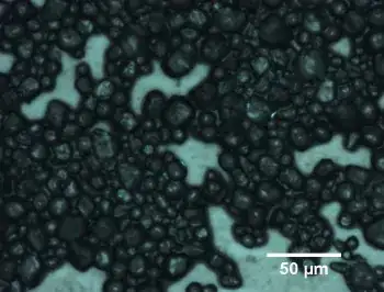

I can address one class of non-Newtonian fluids consisting of solid particles dispersed in a liquid medium, such as the cornstarch and water mixture commonly called "oobleck." In more scientific language, I am talking about concentrated colloidal suspensions of particles. Here is an image of oobleck, taken from Dounas-Frazer et al 2012.
microscopic view of oobleck
These fluids tend to be shear-thickening, as you describe. Their viscosity increases substantially once the fluid velocity increases above a critical value. This tends to make them stiffen in response to impacts, which allows for fun activities such as running across the fluid surface (watch http://youtu.be/yHlAcASsf6U and related videos. The Faraday waves are also especially engrossing).
Here's how the shear-thickening comes about: Imagine a velocity gradient in the fluid. Then grains in one layer of the fluid will have to "roll over" particles in another layer of the fluid, colliding with each other as they do so. The steeper the velocity gradient, the more the fluid will tend to "dilate" in the direction normal to the gradient. But once the dilation effect gets sufficiently large, the water's surface tension provides a confining force that resists further dilation. This makes it much harder to maintain the velocity gradient and so the viscosity goes way up. (This explanation is based on the discussion in Fall et al 2007).
