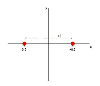

Suppose we choose our coordinates so both protons are on the $x$ axis, at $x = -0.5$cm and $x = +0.5$cm:
Protons
The distance $d$ between the protons is obviously 1cm - well, that may seem obvious but actually it's only true in flat spacetime. More generally the geometry of spacetime is described by a quantity called the metric tensor, $g_{\alpha\beta}$, and the proper distance between the two protons is given by:
$$ d = \int_\text{x=-0.5cm}^\text{x=0.5cm} \sqrt{g_\text{xx}}\,dx $$
In ordinary flat spacetime the value of $g_\text{xx}$ is constant at one, and the integral turns into:
$$ d = \int_\text{x=-0.5cm}^\text{x=0.5cm} dx = 1 \,\text{cm} $$
