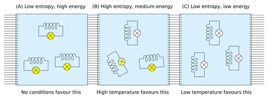

The state of the nano-circuits can be classified as one of the following three:
State A outputs large amounts of energy but is a low entropy state and therefore (due to the free energy being $F=U-TS$) will never arise.
State B consists of high orientational disorder which will generate light (or some other energy output). Due to the high entropy, this will be the favoured configuration at elevated temperatures. You correctly suggest that the energy will be extracted from the kinetic energy of the water, causing the temperature to decrease.
As the temperature decreases, the water will jiggle less, reducing the energy yield of the nano-circuits. As the temperature decreases more and more, one of two things could happen. The nano-circuits may retain their high entropy state, but the lack of brownian motion eliminates the energy output. Or (in an ideal case) the nano-circuits will align in a low-energy state (C).
