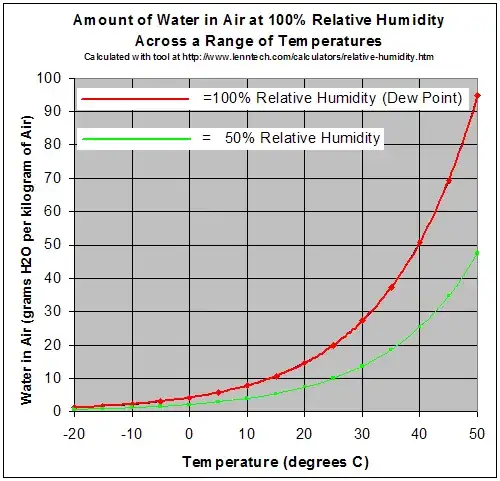

Wikipedia graph - Water in Air at 100% RH
Figure 1. Source: Wikipedia Commons.
The Wikipedia article on relative humidity states:
A useful rule of thumb is that the maximum absolute humidity doubles for every 20 °F or 10 °C increase in temperature.
A coarse thumb, perhaps, but it gives the general idea.
I was giving a class today on psychrometric charts - a case of the blind leading the blind - when one person asked, "What determines the shape of the 100% curve?"
Has anyone got a simple answer?

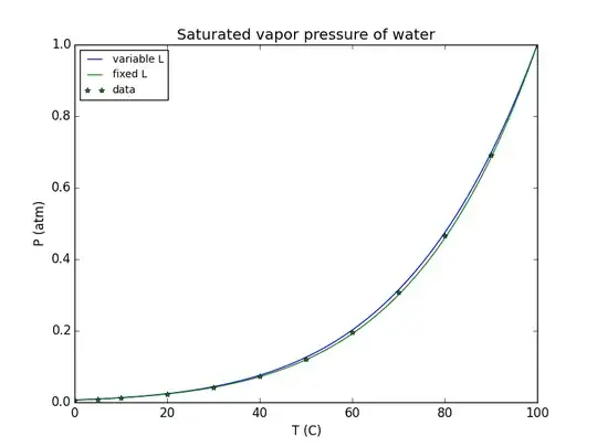

UPDATE
I decided to try to do the integration for both fixed and variable $L$, using 45 kJ/mol at 0 °C dropping to 40.5 kJ / mol at 100 °C (linear) as an approximation for the real behavior of water vapor, and comparing to the results obtained when assuming a fixed value of 42.7 kJ/mol. I adjusted the scale on both plots to put $p=1~\rm{atm}$ at $T=100°C$:
For reference, the green dots were taken from the table on this page. It all agrees rather nicely, and the difference between using fixed $L$ and variable is quite small, showing that the "fixed L" approximation is reasonable. The difference is about 5% at its worst point.
