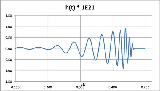

From the discovery announcement of GW150914, I created a facsimile of the measured strain signal:
h(t)

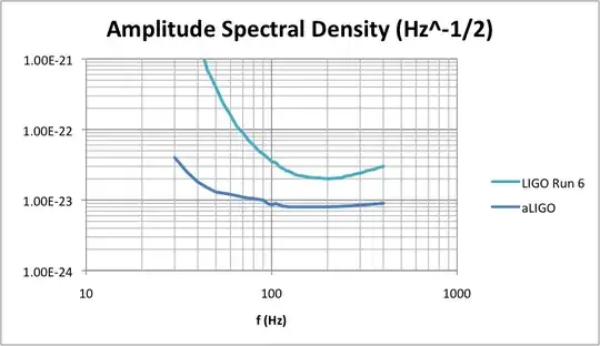

From that paper and also the summary of Run 6 of original LIGO, in 2009-2010, I digitized amplitude spectral densities of the two:

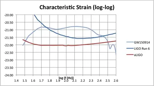

From these inputs I calculated the characteristic strain and noise curves:
Integrating these up per the very helpful reference identified by Will Vousden, I calculate the following results for signal-to-noise ratio $\rho$ for a matched filter:
\begin{equation*} \begin{array}{lcccc} \text{detector} & \rho & \chi_r^2 & \hat{\rho} & \hat{\rho_c} \\ \text{aLIGO} & 18.73 & 1.44 & 16.69 & 23.6 \\ \text{LIGO run 6} & 4.88 & 1.44 & 4.35 & 6.2 \end{array} \end{equation*}

Since the Run 6 signal-to-noise ratio $\rho < 8$, it would have been very difficult to claim a detection: in this review of Run 6's search for massive black hole inspiral/merger signals, Figure 2 shows that signals with these values of $\rho$ and $\chi_r^2$ would be buried in noise events.
Curiously, that same review includes Figure 1, which appears to show a 60 total solar mass event being detectable out to about 470 Mpc (with favorable orientation), which would include most of the the reported distance range of $410_{-180}^{+160}$ Mpc. I cannot explain the discrepancy.
