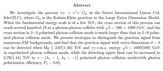

Well, phenomenologists never give up. Here is a paper peer reviewed which explores the discovery of gravitons in future, but not too far future, colliders.
graviton
All one needs is large extra dimensions in a string theoretical model, to give predictions.
Two birds with one stone, graviton and extra dimensions.
