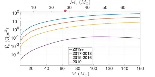

On that note, the volumes we're talking about are due to get even larger in the next few years. Below is a panel from Figure 4 of the 2016 LIGO astrophysical implications paper (ApJL 2016, 818, L22). It plots effective volume coverage (which weights the fact that orientation of non-monopole emitters and receivers can make you miss some events and see others at the same distance) as a function of chirp mass (the reduced mass most relevant for two inspiraling objects in GR). The volume coverage for events like the one seen (marked in red) could very well increase by a factor of $10$, and the farther-away detections will have larger potential volumes from which they originate, assuming fixed fractional uncertainties in distance.
volume sensitivity as a function of chirp mass

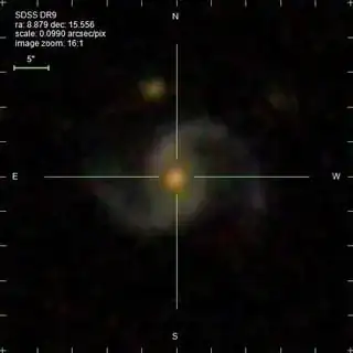

For a concrete visual demonstration, I randomly picked a galaxy not too different from Andromeda (a bit dimmer at absolute g-band magnitude of $-20.2$) at $z = 0.122$. This is SDSS object J003530.92+153322.6, an image of which is below.
image of SDSS J003530.92+153322.6

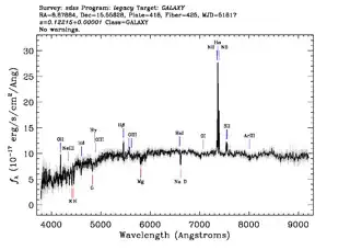

In fact, this distance is close enough that reasonable galaxies can have spectra taken. The below spectrum was taken for the example SDSS galaxy above. With integral field spectroscopy on the rise, we can expect to have many spectra from different parts of such galaxies, yielding better information about the internal structure.
spectrum of SDSS J003530.92+153322.6
