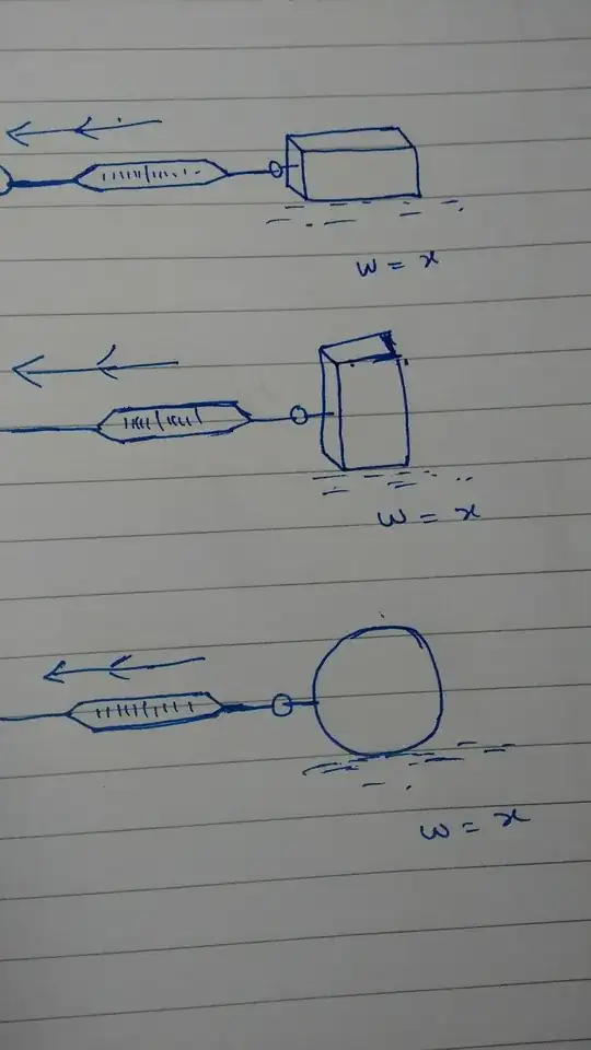

What will be minimum force required to move the objects in above pictures assuming the weight of the objects is same and material is also same. Will it different for each object or not?

$$F_{friction} = \mu \cdot N $$
$\mu$ is the coefficient of friction, $N$ is the normal force.
That formula is as basic as it gets when describing friction. There is no dependancy on surface area. Assuming that all the objects have the same mass, and that no energy is lost (e.g. no energy wasted on rotating the object), then the force required to pull the objects would be the same (i.e. the frictional force is constant).
If the frictional force increases with surface area, the normal force must also increase according to the formula. From Newton's 3rd law, the normal force is equal to the weight force. Hence for friction to increase, the weight must also increase, which is against the bounds of the question.
As for why it has no dependancy on surface area, realise that as the surface area increases, the force is more distributed and hence there is a lower pressure at the surface between the object and the ground. If the area increases, the pressure must decrease. There is an inverse relationship between pressure and area, therefore the force remains constant.
$$P = \frac{F}{A}\\ F = P \cdot A$$
