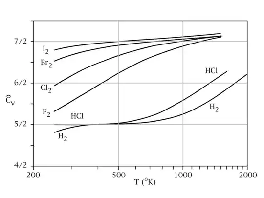

Heat capacity of diatomic gases
According to this diagram (from Wikipedia), it seems that vibration is prominent for heavy molecules, at high temperature, but we can neglect it for small molecules, or at low temperature (you could say that this diagram can't help us distinguish between rotation and vibration, yet a quantum model would confirms this).
