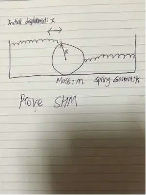

Given the stated system in the photo we are suppose to prove simple harmonic motion when given an initial displacement $x$
Problem statement
I first considered the total energy of the system which we will call $H$ $$H=\frac{1}{2}mv^2+\frac{1}{2}I_{0}\omega^2+2\left(\frac{1}{2}kx^2\right)$$
However if we take the point to consider as the contact region between the circle and the ground we can take away the translational kinetic energy term and it reduces to
$$H=\frac{1}{2}I_{1}\omega^2+2\left(\frac{1}{2}kx^2\right)=\textrm{constant}$$
We note that this equals a constant by the law of conservation of energy Then consider the total time derivative of $H$ And we note that differentiating a constant gives us 0
$$\frac{\mathrm dH}{\mathrm dt}=I_{1}\dot {\theta}\ddot {\theta}+2kx\dot {x}=0$$
We convert from polar form to generalised Cartesian coordinates
$$\frac{\mathrm dH}{\mathrm dt}=I_{1}\frac{\dot {x} \ddot {x}}{R^2}+2kx\dot {x}=0$$
$$I_{1}=\frac{7}{5}mR^2$$
Substituting I yield..... $$\frac{\mathrm dH}{\mathrm dt}=\frac{7}{5}m\dot {x} \ddot {x}+2kx\dot {x}=0$$ Doing some manipulation.... $$\frac{7}{5}m\dot {x} \ddot {x}=-2kx\dot {x}$$
We can then cancel out $\dot {x}$ from both sides
$$\frac{7}{5}m \ddot {x}=-2kx$$
I'll skip some steps and simply completing the manipulation we obtain
$$\ddot {x}=-\frac{10k}{7m}x$$
which resembles the form $a=-\omega^2x$
where $\omega=\sqrt{\frac{10k}{7m}}$
Most importantly, why does this method work? And what is this method called as I have never seen it before, I heard my friends briefly mentioned this is a Hamiltonian but it doesn't resemble as such Is this a valid method to approach mechanics problems by writing down the total energy and taking the time derivative as being equal to zero?
