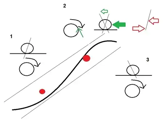

There is one important point missing here on the given answers. The main point of the question actually. It's important that the ball hits to the second pin. This contact is the clue to change the direction of the bowling ball.
As it's stated in the question, there is no way to do an half-eight or S; You can have J-curve or C-curve, but S needs an external force, or it would be a violation against newtons laws.
At the picture is shown how this goes.
  1. Is the starting position of the bowl.
  2. Shows how the contact in Pin (RED) causes a force described with green arrows, and makes the rotating axle to flip. RED arrows shows where the flip momentum comes; the floor friction and the collision point are at different heights-> Rotation follows
  3. is the initial position of bowl which causes it to curve in another direction.
