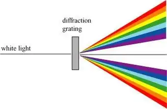

Here is a highly stylised diagram of what might happen to white light which is made up of many wavelengths
Note that the same effect can be obtained from a whole lot of reflecting surfaces as there are on a CD or DVD.
