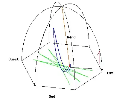

As CuriousOne commented, the Foucalt pendulum is another demonstration
enter image description here CCASA3 Nbrouard 2007
A Foucalt pendulum at the north or south pole rotates 360$^\circ$ in a day. Elsewhere it's angular speed is $\omega=360\sin\varphi\ ^\circ/\mathrm{day}$ where $\varphi$ is the pendulum's latitude.

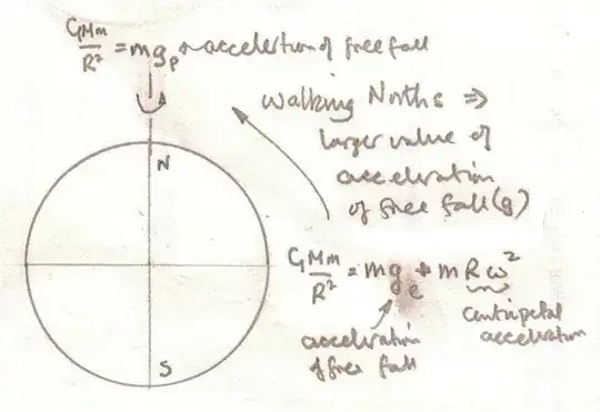

Ignoring other effects there is a variation of the acceleration of free fall when travelling from the Equator to the Poles.

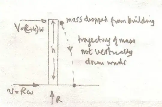

Dropping a stone from a tall building will result in the stone not falling vertically downwards.

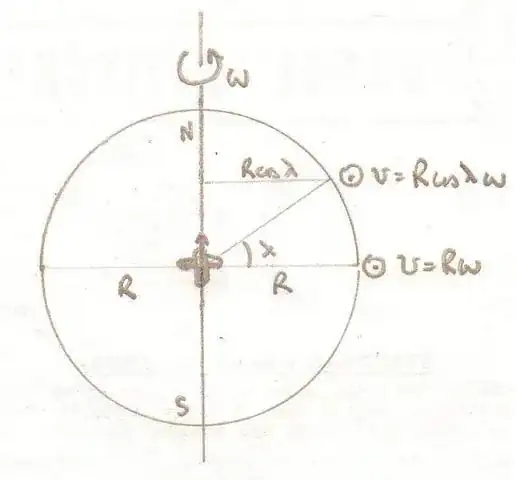

An aeroplane flying due North ends up East of its target.
