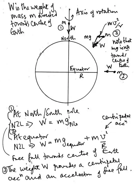

I also know that my normal force and gravitational force cancel.
But not exactly and that little bit of force produces your centripetal acceleration. It is one of the reasons that your weight as measure at the North Pole is greater than your weight when measured at the equator.
